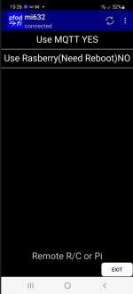

Here the simple raspberry / mqtt page:

Teensymower connected to pfod-app: This is the current status of the connection - connected to android-app (?). Below that is the html page of the web server. I do not know whether both connections can work in parallel. Or I misunderstood something. When is "connected to pfod-app" coming?
Each time you connect the pfod app the webserver is stop, message appear and everything work perfectly .
