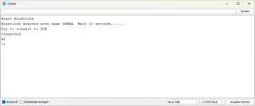

If ESP32 use the simple firmware , you can add the ide console output to all transmission data by this way
Code:
// ESP-32    <--> pcb1.3 pin mapping:
// Vin       <--> 5v ON BT CONNECTOR
// GND       <--> GND ON BT CONNECTOR
// RX2       <--> TX ON BT CONNECTOR
// TX2       <--> RX ON BT CONNECTOR
#include "BluetoothSerial.h" //Header File for Serial Bluetooth, will be added by default into Arduino
BluetoothSerial ESP_BT; //Object for Bluetooth
void setup() {
//BT seial for Pfod init
  Serial.begin(115200);
  Serial.println("Start Bluetooth");
  ESP_BT.begin("DENNA");
  Serial.println("Bluetooth started with name DENNA  Wait 10 seconde......");
  delay(10000);
  Serial.println("Try to connect to DUE");
  Serial2.begin(19200);
  Serial.println("Connected");
void loop() {
  while (ESP_BT.available()) {
    Serial2.write(ESP_BT.read());
    Serial.println(ESP_BT.read());
  while (Serial2.available()) {
    ESP_BT.write(Serial2.read());
    Serial.println(Serial2.read());
this is the answer from arduino console...

So I'm pretty much at a loss!?
Unfortunately, I can't get any further with the app connection. According to Teensy, everything is fine. But something doesn't seem to be right.
I also have the baud rate at 19200 for both as with the first mower. I measured Rx and Tx, the connection between esp32 and teensy is also fine
