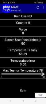

Max temp is not in the firmware , it's into arduremote setting, so you don't need to upload sketch again or only for frequency clock change.
What you find in the firmware is the factory setting and it is replace when mower in powered on by the one locate in the memory.
here my setting and temp, it's 32 deg outdoor.
Last year in really high outdoor temp i have trouble and set max temp to 78 deg and the teensy is always working ,so i never recommend this ,but it can work :ROFLMAO: Screenshot_20240717_183109_pfodApp V3.jpg.
Oh, thanks Bernard! I think I must be blind. I have search for the temp setting over a half hour in the pfodApp, before I updated it with the firmware:ROFLMAO:
I hope 65C will be enough with a small heatsink on the teensy. If not, now I know where it is to set.;)

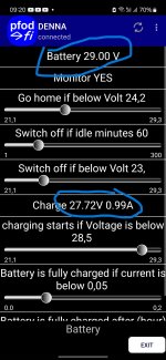

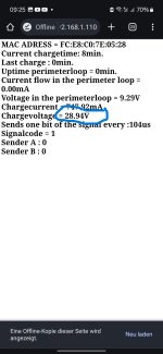

A question to the voltage detection on the INAs: are here big differences between the INA modules, that these show around 1.0- 1.6V more than the reallity?
Screenshot_20240718_092046_pfodApp V3.jpgScreenshot_20240718_092546_Chrome.jpg
Here the charging & battery voltage was around 27,4V (measured with multimeter on the battery and on the charging pins.)
Is here an option to adjust these displayed voltages?
View attachment 1699View attachment 1700
For battery voltage, it's D5VoltageDrop into mower.h but it's strange that you need a negative value, i never test.
Code:
// ------- select one mainPCB -------------------
#define PCB_V101
//#define PCB_V103
#define D5VoltageDrop 0.8  //correction of battery voltage
For charge voltage i can do the same into futur firmware version.
