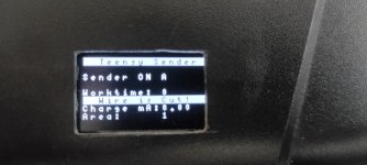

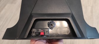

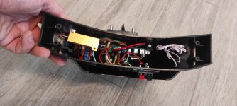

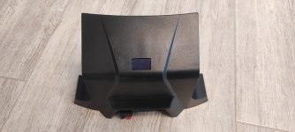

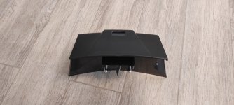

My Teensy Sender ist ready.
I hope it will work this year without problems.
Thanks to Sasha and Bernard!

Oh cool that the PCB fits into the housing.
Is the OLED waterproof or do you have a roof over it?
I'll test your code on my computer in a few days and upload it to Github along with the other code.
For the First time, I will disconnect the transmitter after use and take it in into the dry. a nice garage is planned. The display is only attached with hot glue.
