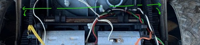

what is the best place to put them?
Here on each front side .

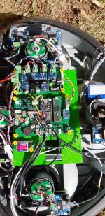

Send image of the assembled Power PCB
Check SDA and SCL order in the ina226 ship to see if it's ok according to the PCB.
Check the shunt at back of the INA226.
Here it is, thanks for your help!

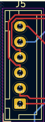

On some INA226 board the SCL SDA pin are swap
Your SCL and SDA are inverted comparing to PCB.
Simply swap SCL0 SDA0 and SCL1 SDA1 on J5 connector, but i see black and red wire on strange location on J5 3.3V is normaly at top of connector.
