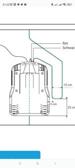

How did you route the perimeter wire to the garage? I have now chosen a distance of approx. 5cm to the 2nd wire, so that the mower drives properly into the garage. If I put the wires closer together, the mower won't go into it. He turns and drives round and round.
I think that the distance between the wires is too big?!? Isn't it?
Only one wire need to reach the garage and the second one is at back or at least at 90 Degres if garage is locate into angle.
I see... That's my fault... 🤦
Like in the picture below. That's the right way... I have made it wrong.
