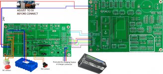

Thanks Sascha, I know now what sort of Resistor I have to order, thanks !
Thisone, is ok if your loop has 0 Ohm, I don't think so... ?
If you adjust your DC/DC converter to 12V then R loop+R added=12 Ohm to obtain our 1A.
Have you measured how many Ohm has your loop ?
If I measure the cables directly I have 4 ohms (circa 200 Meter Cable), if I measure the contacts I only have 1 ohm. But I haven't checked this yet because it's always raining and snowing here.
Maybe 12 Volt is big value.
I use
9V and 1010 mA on a near 300 ml loop
and
9V and 380 mA on a near 100 ml loop
Signal is OK everywhere at 15 ml of the wire and max mag is near 4500
Bernard, I red that we have to use U=RI to find the right value for the added Resistor, to bring courant to 1A .
So, you think 9V should be enough, it means for Sascha to adjust the DC/DC output on 9V and determine the Resistor on this basis.
=> R loop + R added = 9/1
=> 4 + R added = 9
=> R added = 5 Ohm should be ok in this case ?
If he decide to keep the 12 Ohm Resistor, on 9V , the courant will be 0.56A, for now on 12V => 0.75A.
True., but 12 V and 1 A are the max value.
It's OK for the 2 solutions.
Simply test first at 9V and if signal is not OK adjust it up to 12V
Perfekt, thanks Bernard, it means it should work for Sascha, and I will first start with 9V on something like 0.5-0.6A.
Sascha could adjust the dc/dc output on 9V.

The Sender is ok. One week just to build thisone.
I had to change many things on 3Dprints to be ok with my expected configuration.
